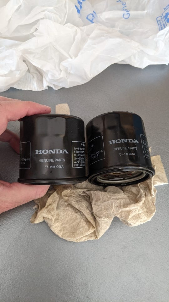

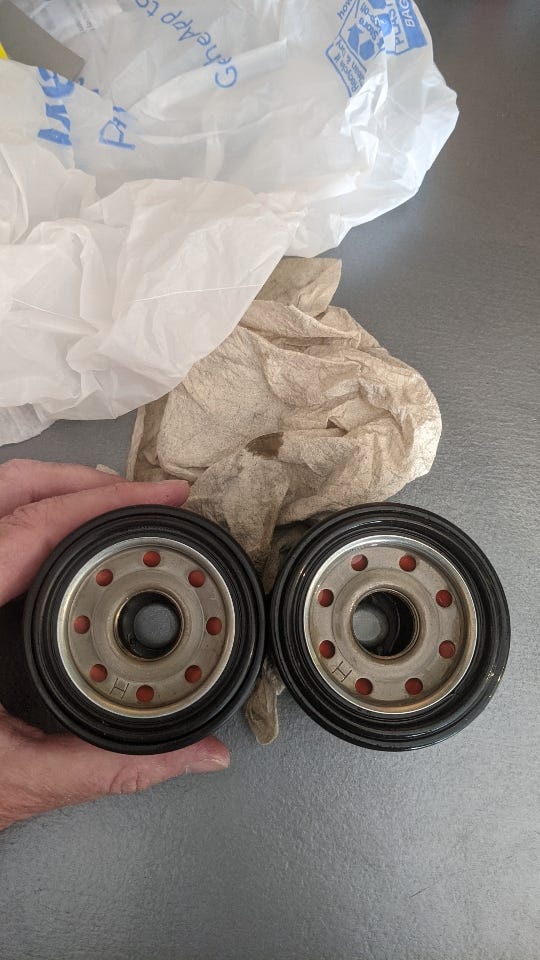

I trust Fowler’s too. I now have both filters at home here D02 and 505, they are physically different though , one has 6 larger holes, the other 8 smaller holes. I haven’t actually worked it out but I did wonder if the area of the holes is actually the same? I was curious why they changed, there must be a reason. Oil flow? Oil pressure? Something to do with Euro5? In the end I went with the D02 simply because that was what I took off, I will use the others up another time. They are on the shelf waiting patiently……
I‘m equally curious. I think it’s having an engineering background ?
I too reckon it could be down to flow or pressure, but Honda will never explain themselves, I’m sure !
However, it could simply be Honda trying to rationalise the number of different part-number filters they produce across their range of bikes ?

Hi ArtyY
Just taken a couple of photos of the one I bought yesterday.
Seems they’re made in France by a company called Purflux.
I was certainly comfortable using the 505 on my mate’s CB1000R as it’s the very same part number that’s quoted for my own 2017 Fireblade SP. I’ve been using them
for the last 5 years without the slightest problem (I‘ve done ALL my own oil changes from new)
Hi ArtyY
I was certainly comfortable using the 505 on my mate’s CB1000R as it’s the very same part number that’s quoted for my own 2017 Fireblade SP. I’ve been using them for the last 5 years without the slightest problem (I‘ve done ALL my own oil changes from new)
