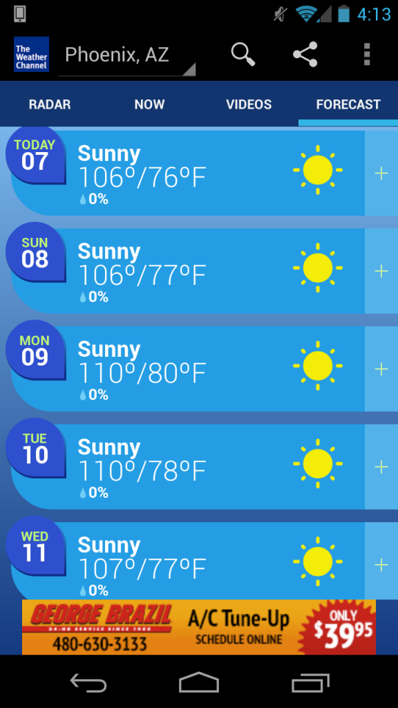

Speaking of hot... Beginning of June and here's our forecast... Going to be a hot summer, especially a month from now when we get further into summer
